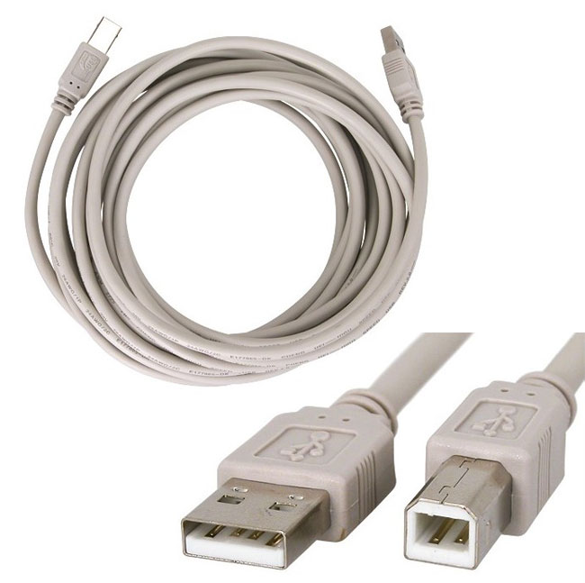

Would anyone know if the Music Fidelity VDAC is compatible with AirPort Express? I am looking at getting a DAC this week - I contemplated the Cambridge Audio but budget is tight, thus the VDAC seems the next offering I can go for. I notice it has a USB port, but its not a standard port. Does anyone know if I can use it for sending tunes from iTunes? (AirPort).

The USB on the V-DAC will work straight from your PC, but USB from Airport Express to any DAC doesn't work. It does however have an optical out from the headphone socket, and the V-DAC has an optical in, so Bob's your uncle.
EDIT - not sure what you mean by "not a standard USB socket", since it looks it to me (well, the irregular hexagon style which is a standard fitting for peripherals - freely available cable shown below).

Ah - yes, thats what I meant. Its just a conver cable then. Got it. Thanks for clearing up my misunderstanding of the APExpress connections too - I thought I went straight into the DAC! I'm def planning to plug the TV straight to the optical in. So frustrating the TV (New LED) has no phone.
